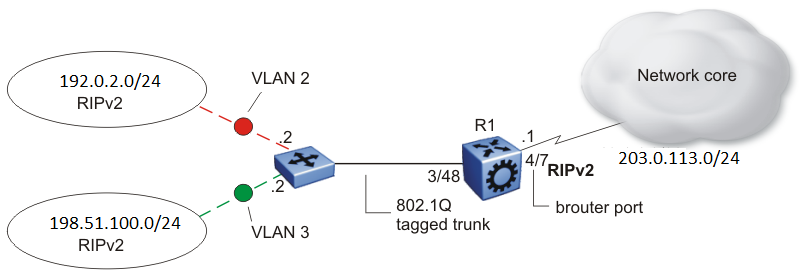

The following configuration example shows how to configure the switch (labeled R1) to operate only in RIP version 2 mode.
Enable RIPv2 send mode on VLAN 2:
Switch:1(config-if)# ip rip send version rip2
Enable RIPv2 receive mode on VLAN 2:
Switch:1(config-if)# ip rip receive version rip2
Repeat these commands on VLAN 3 and the port interfaces.
